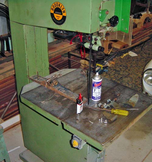

The saw is an Aussie made Brooklyn and is about 10 to 12 years old. The tiltable cast iron table is 32" wide x 24" long, the rubber tyred, cast iron wheels are 23 5/8" (600mm) in diameter and are 1 3/8" (35mm) wide, fittings are cast, and it has a foot brake, dust shoot, and a full 180 deg swing blade guard.
It should take an 1 1/2" blade and has a potential maximum depth of cut of 14 1/2", however I think the little 2hp 3ph Italian motor may struggle with that much wood. But then again, it is a relatively cheap and easy upgrade to bolt a 5hp in place of the 2. The depth of throat at 22 1/2" is plenty for me and the "Jolly" brand guides are micro adjustable.

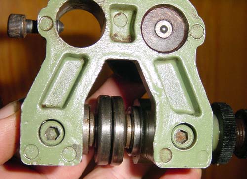

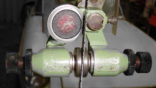

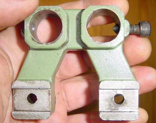

This saw has had moderate use in a cabinet shop, mainly working panels on the odd occasions that curved work was undertaken, however the term "regular maintenance" seems to have slipped by the PO and the Jolly guides, whilst working fine now, where very stiff from lack of lubrication and it did take a good amount of time cleaning and oiling to get them running smooth.

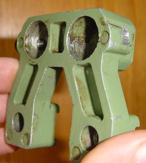

Also on the guides, the threads in the rear blade support bearing adjustment pinch bolts, on both upper and lower guides, have been stripped out by some gorilla with a spanner. I have rectified this problem temporarily via the use of 2 hose clamps and whilst this fix will work OK, I would prefer to either repair the existing guides properly, or replace them with full roller bearing guides along the line of Carters only bigger.
A while back, I seem to recall someone recommending a brand of replacement bandsaw guides, I think it may have been Paul but I can't be sure and have not found anything in my quick search of the archives. So if anyone has any suggestions, or knows of a distributor for Jolly, please let me know, the shaft diameter for the guides is 20mm.
Here is an image of the existing top guide.
And here is another that gives some idea of the depth of cut, the fence and fence slide rail have been removed for transport, this is one heavy saw. The old plane sitting on the table between the blade and the neck of the saw is a No7 Record jointer thrown in along with a BIG pile of other stuff some not so good, some very good indeed
All in all, I am very happy with this saw. I could have bought a new Asian saw for the $1300.00au I spent on this one, but I think with this ol'girl I could cut Asian saw veneers if you know what I mean

Are the stripped parts aluminum alloy? I see the problem if that's true. Surely there is a repair or replacement of that part.
Larkim, these look exactly like the old Luguna Euro Guides, except for the fact that the Lagunas were a bit smaller and were easy to stop with dust.
They were spark throwing monsters, espescially on the rear thrust bearings. Scorching, sparking, glowing red band blades, it was a true hazard and ruined a bunch of wood until I got the machinist to make rear bearing shafts that replaced the euro setup. I think they made them smaller which gave them less ability to turn under face friction.
With the stubby shaft and a ball bearing inserted on it, and an E-clip, I was set to saw, and haven't looked back. Bruce Dickey38830.834525463
PostPosted: Sun Apr 23, 2006 12:38 pm

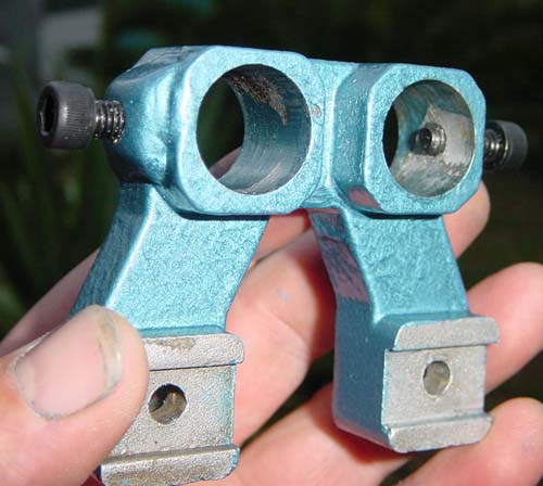

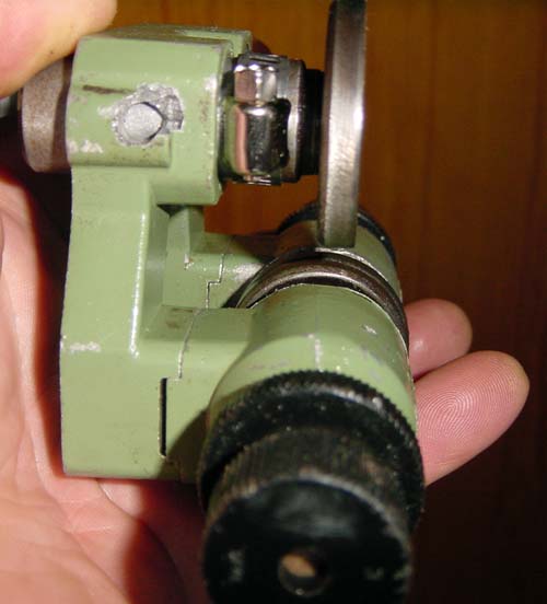

Yep, the guides are the only aluminium alloy on the whole machine. As you will see from the images, if worse comes to worse I could make a new housing from steel as the adjustable side guides are held in place with an allen key. If I do go down that road, I will address the thrust bearing issue at the same time and replace with a roller bearing as you suggest Bruce.
The hose clamp you can see in the first of the attached images is just a quick work-around that will allow these to work fine for now but do limit the blade size you can use somewhat.
I may be able to fix these more satisfactorily with a bit of Devcon, but the best fix would be to replace the housing with a new one. Problem there of course is that finding anything on "Jolly" is proving difficult
If Paul Woolson tunes in, I would like to know the replacement guides I think he mentioned and posted a link to a few month back, but then I may be wwwrrr..... wwwrrrooo.......wwwwrrrrroooooonnn Oh never mind.

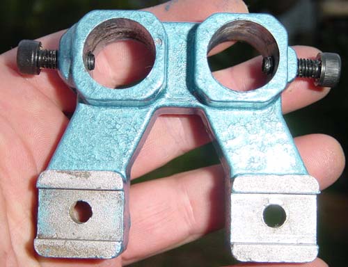

Thanks for the link Colin and thank you very much Bruce for taking the time to PM me with your advice. But, I am very happy to announce that a solution is at hand .
You see I took the housings to a specialist welder and ask him if he could do anything with them. He took a quick look and said he would give it a try but as there would be a good deal of natural stress built in from casting, they could well crack at the thinest edges around the guide post hole when heated. I told him to give it a go.
Here is the result As you can see after a bit of shaping with a file and abrasives, a quick drill and re-tap plus a coat of paint they look OK. If you compared these to the images in the above post, you will notice that there is now substantially more meat for the thread, so hopefully this problem will not be re-visited.
I had blue paint in the shed, so they are now blue instead of green but thats OK cause I dig the blues
Sometimes it is good to be wrr.....wwwwrrrrr....wwwwrrrrrooo.....mistaken you see the housings are aluminium and not die-cast alloy after all. So they were weldable all along .

Great repair, just what you needed. Better than a new part most likely. Hi fives to the welder and you for perseverance!
